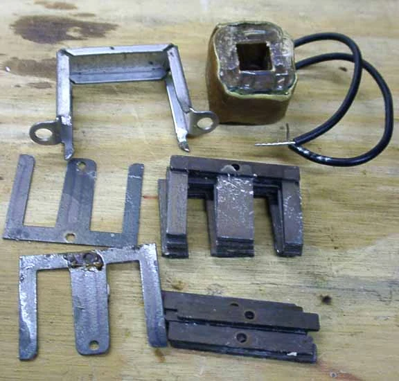

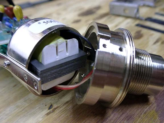

Attached is a pic of the transformer in the MXL V67, and a disassembled transformer (not a mic transformer). The mic transformer may be easier or more difficult to work with, depending on the type of laminations and how they are interleaved.
I think even a competent, not skilled, person should have a failure rate approaching zero for this, as long as he takes notes as to what hooks to where.
Yep. You just slide the new lams in, wrap some special tape around it (should be included in the kit) and you're done. NO ROCKET SCIENCE REQUIRED. ;)
