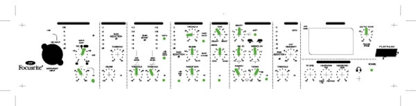

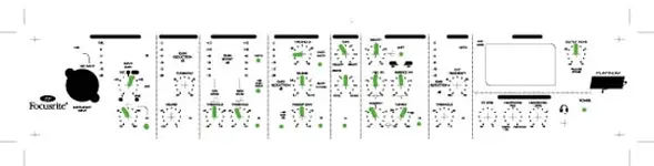

Ok, here are some tips for NTK vocals on a VMP or TT from focusrite. I have marked the settings in green. If there is no green dot, don't activate that feature. You may have to blow this up to see it better, this is as large as I can get it. The neat thing about these units is that you can order the chain of effects. In this instance the chain setup is Preamp to Vintage Harmonics (for those tube harmonic sounds) to EQ, then the Opto Compressor and finally Tube Saturation. The De-esser is not required for the NTK if you keep it above the mouth. The expander is virtually worthless in that it has a grainy response. Good for maybe drums to block out room noise, worthless on vocals. These settings are for a male vocal, ballad thingy or maybe easy rock tune.

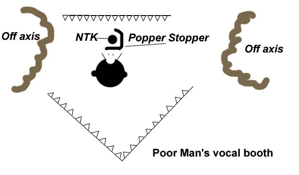

Here is my setup for vocals. Captures the voice like a booth and the off axis room noise is almost eliminated. You just need one corner of your room. Put the corner to the vocalists back and voila, instant booth type sound. The jagged thingees are foam panels. The one in front of the vocalist is a moveable panel.
