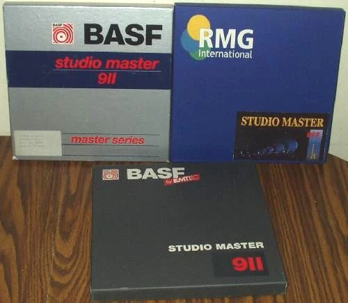

And here are my own pics of my various 1/2" SM911... Pre-EMTEC BASF, BASF by EMTEC and RMGI. They all look, smell, feel and sound the same. And I won't sue anyone if they want to snatch the photos for their own use. :D
