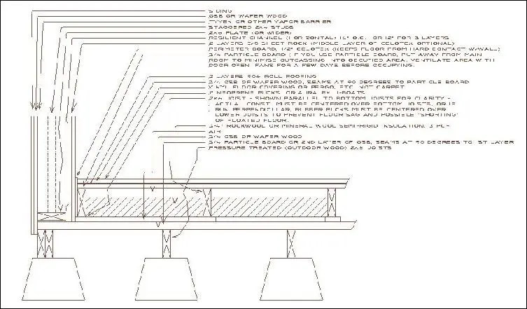

Working on a few CAD drawings (should have done this months ago), will post them when finished (framing details, corner construction, isolation details, etc)
This may take a day or two (Life is the crap that happens to you while you're busy making plans), hope you can wait because it will help you a TON... Steve

No prob, Jim - got the first one done sooner than I thought (too damn hot out to do what I SHOULD be doing :=)
Hope this translates to low-res brousers OK - Crap, not very good - the first one was about 30K too big for upload rules - I'm gonna try it at John's site under Construction forum, gonna post all the dwgs there anyway... Steve

Hey Steve!

First let me tell you that the foundation will be built on skids (4x6's) as on a portable building, meaning there will only be concrete pylings to compensate for grade and the joists will be 2x6 green wood on 16" centers. Hope this little bit of info is usefll.
By the way, the chart for me is barely ledgable and I really want to review them, could you possible send t hem to jim-delisio@webtv.net ? That would be great!

There is a higher resolution version I just posted here
http://www.homer.com.au/phpBB2/viewtopic.php?p=1959#1959
I'm planning corner details, a recap of wall details, RC installation tips, etc - it will take time, but if one of those would do you more good right now I'll try to work on it first.
Let me know back if the link has a sharp enough copy, assuming you're still online... Steve

Sorry Steve, I still cant make out the wording on the digrams, damn, But I think I have a grip on the general logic involved, mainly its mass, air and isolation, Truthfully, at this point, Id welcome any documentation pertaining to any and all phases of the soundproofing process that are related to my particular situation.

What resolution are you using? I did those on a 1024 x 768 LCD, and they show up fine.
I'll see if I can make the text part bigger tonite if things are slow at work... Steve
Here's another quick thing to try, I just did it - go to the bigger file on John's site, right click on the picture, click Copy, then open paint, do a Ctrl V (or edit/paste) - then, click view, zoom, custom, and choose 200%. Scroll to the text and it should be readable.
I do my drawing in a CAD program, which is vector based - the fonts don't translate very well when you convert to a raster-based format like JPG - I'm going to try a few different things soon to see which works best for this type of conversion. Meantime, get the file from John's, dump it into paint, zoom in 200%, and it should work.
BTW, everybody, this particular design is not what I consider to be the BEST soundproofing of all time, not by a long shot. What it is, is really good soundproofing for a room that is on skids and may be moved. Some of the better methods of sound proofing wouldn't stand up to that kind of abuse, and since this was originally drawn in answer to Jim's question the drawing was geared to his situation... Steve
