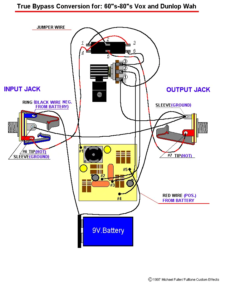

Found this data at a site mentioned in an old thread here. It's a way to modify a standard cry baby so it has bypass.
True Bypass Conversion for '60's-'80's standard Vox and Dunlop wah
includes american and Italian-made Crybaby, Jen, Dallas-Arbiter, and more.
1) Unsolder wires to SPDT (stock switch), remove it, and Install new DPDT.
2) Find Input Jack Terminal "Tip"....unsolder and disconnect only the short wire, follow that wire to the circuit
"Input" (Marked #1 on PCB Diagram), unsolder and remove it here as well. Leave in the long wire on Input Jack
"Tip" terminal and resolder it to make sure there's a good connection.
3) Run this wire from Input Jack "Tip" to DPDT terminal #4 and do not solder.
4) Attach the wire from DPDT terminal #4 and jumper it to #3 solder both
5) Attach a wire from Output Jack "Tip" to DPDT Terminal #5 and solder.
6) Run a wire from PCB terminal #1 up to DPDT Terminal #2 and solder.
7) Attach short wire from Wah Pot terminal #3 to DPDT terminal #6 and solder.
8) attach a short (ground) wire from Wah Pot Teminal#1 to DPDT Terminal #1 and solder
