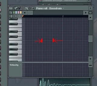

I have tried what you say, but I'm still not succeeding..
Look at this screenshot:
I have marked the division of one beat. You see 4 blocks. I cannot make triplets this way. I cannot find a setting to change this division.. I don't want to change the "project settings" for all the patterns. I want my "project setting" to be 8/8 or 16/16, and remain that.
Can you tell me where in the piano roll I can alter the time signature for this specific pattern and sample to make "triplets" without affecting the overall setting?
BTW I'm using FL Studio Producer 4.0.1 now...
Thanx in advance,
Saz

i tried using the snap set to 1/3 and 1/6
to make bass drum triplets but changing the settings didn't seem to make a difference. Any ideas?
Chrisjob said:
Set the snap control to 1/3 or 1/6 beat for triplets
Thanx again!
Do you mean:
Going to the pianoroll options, using tools -> quantizer. Importing another "groove". I found a " third" and a "sixth" based file.
I've succeeded in hearing triplets this way, the only thing is that I cannot "position" the samples there by mouse. I need to play them with a 4/4 feel, and then change the time division to hear the triplets. [kinda odd, NOT to program initially what you want to hear eventually] But "placing" any samples anywhere as triplets with the MOUSE seems impossible... The grid KEEPS snapping them to 4/4 wherever I click.. With quantizer I can "morph" the rhythm into triplets.
Is this the only correct way though? Or is there a way to "position" triplets by hand?
[The reason I'm asking this, is: "If I want to record an asymetrical pattern consisting of both 6/8 and 8/8 feel, it's very hard to play a bassdrumline "straight" and anticipate in advance on how the samples will be "moved" by the quantizer.. "]
