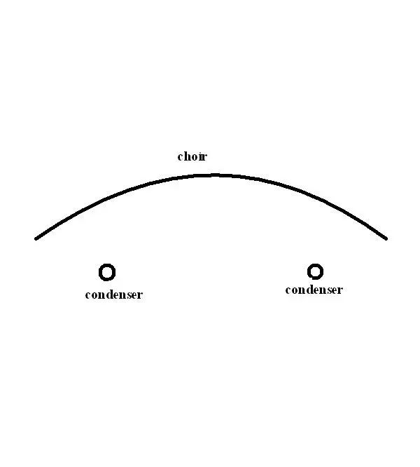

this is a great mic setup which worked out great
the mics should be about 2-5 feet away from and 2-5 feet above the choir
notice how the chior is curved the picture isnt tht symetrical but the mics should be equidistanton either side while minding the 3 foot rule
