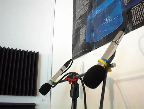

I'm the Mcguyver of cheap. If it can't be done with zip ties and duct tape I don't wanna do it!
I thought you losers :eek: might get a kick out of my new stereo mic stand. It will be fairly permanent so I don't care about having the mics stuck there. The mics are suprisingly adjustable and I can tilt, swivel and offset the mics for a few options.
Post some pics of money saving tricks you've utilized in your recording space. I would love to learn a few new ones for myself.

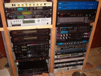

I've attached a picture of my old studio racks, before the tear out. There were four or five of these, I simply made properly sized 2x4 verticals, then attached rack rails to them. Instead of buying rack rails from a music store, I simply took a 7' high aluminum relay rack and cut it into 18U and 6U sections. 6U on top, 18U on bottom, so I could put a small cross brace between.
The rack rails, before mounting, are then cut lengthwise on my table saw, because then I get two rails for the price of one :) There were threaded holes on both sides of the u-channel rails. Why not use both sides? this way, a 42U rack can be cut up to provide 84U of space!
