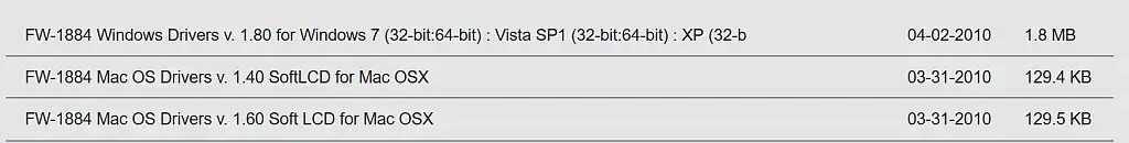

I just picked up one of these for fifty bucks at and estate sale, she fires up and the lights be flashing. Anyway I know nothing about it. I looked at some tutorials and downloaded the manuals. Are the drivers still available for the puter, I read somewhere Tascam no longer provides downloads for the drivers anymore?.dt.jpg
The drivers are online, if you're using WinXP, VIsta or Win 7, or an old version of OSX. Nothing new for 14 years, so Win 10, or OSX past around Snow Leopard might not work. That's the PowerPC era, so it might not work with Intel CPUs.

I remember those, it was one of those units people were distraught when Windows 7 came out and they didn't make 64 bit drivers for it. Only worked on a 32 bit OS unless they finally got around to writing a driver. Which I doubt it.

Windows 10 is on that older computer Tried all the windows drivers available and they will not load on that computer. Unless I install an earlier version I guess it is a boat anchor. No great loss, maybe I can dump it on reverb or ebay.
